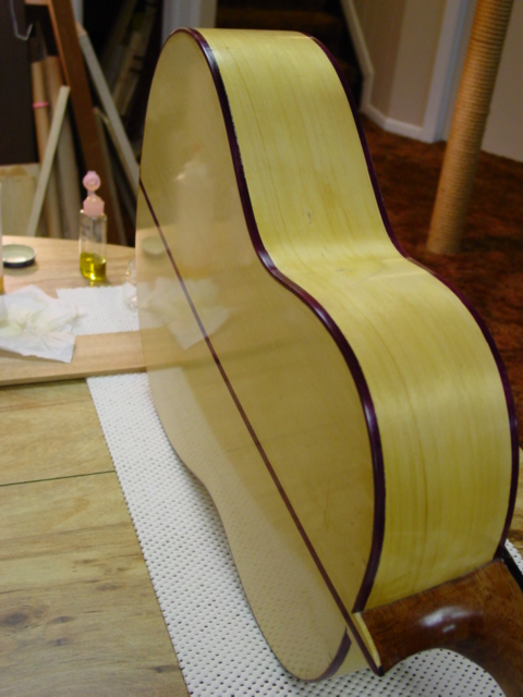

My hat is off to Robbie O'Brien ... and Orville & Robert Milburn too. I had the day off today (paid holiday) and finally had the opportunity to sit down and make my first attempt at French Polishing.
I had successfully bid on and won Robbie's great Finishing DVD here on the forum about 8 months ago when he so nicely donated it for one of our auctions. Since that time I've been meaning to try to learn to French Polish and the Yellow Cedar flamenco that I'm currently working on finally got to the finishing stage and I gave it a try. Robbie's instructions were clear, concise and extremely easy to follow. I went to the Milburn website and read thru their very comprehensive primer on FP also.

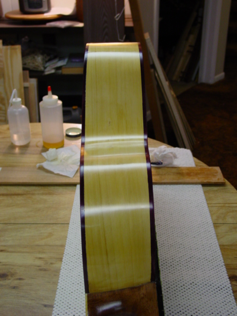

Here are a few photos after my second 'body session' building up the shellac. My prep work was done with a well sharpened cabinet scraper followed by two sessions of thinned Z-Poxy and then sanded with 220 & 400. I've tried to show just how good the gloss level is even at this early stage.
I was really surprised at how quickly the gloss built up even after a relatively few coats/application of the muneca.
I've got at least two more body sessions and will follow those with spiriting, glazing and hand polishing (Meguire's). I'm more than satisfied with the gloss level and I'm sure that I can even get it looking much better than it already is. The nice part about FP is that is is so easy to repair.
I build slowly and don't mind the time it takes to polish. It's very satisfying to get it right the first time.... THANKS ROBBIE !
Pete

PostPosted: Mon Nov 13, 2006 12:01 pm
Impressive, Peter! It looks like you're getting a smooth and even application at the neck/body junction. How are you approaching that area?

Thanks to all for your kind comments.
[QUOTE=CarltonM] It looks like you're getting a smooth and even application at the neck/body junction. How are you approaching that area?[/QUOTE] It seems to be blending well at the junction Carlton. I really tried to get the pore filling nice and smooth in the corner where the neck meets the sides and perhaps it's making the FP go that much easier.
